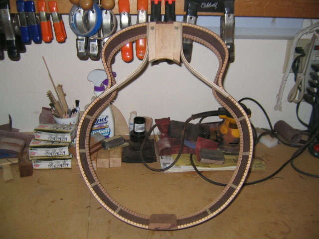

Here's a set braced with a maple veneer/carbon-fiber wishbone. I use this on my Kasha guitars and once removed from the mold, it's extremely stable. I can slip it in and out of the mold very easily. Just one more way to skin the the proverbial cat.
